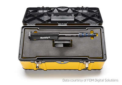

FDM Digital Solutions designed a 3D printed end-application kit using HP Multi Jet Fusion (MJF) technology and HP 3D HR PA 12 material, which can withstand the temperatures required to successfully cure the damaged areas.1
Each kit contains a quick-release clamp that attaches to the heat hose, meaning any of the end applicators could be swapped and changed quickly. HP MJF also allows for:
Improved performance: HP MJF uses a fine-grain HP 3D HR PA 12 material that allows for ultrathin layers of 80 microns, which leads to the creation of parts with high density and low porosity, compared with parts produced with SLS. It also leads to an exceptionally smooth surface directly from the printer, with functional parts that need minimal post-production finishing.
Time reduction: 3D printing these parts leads to short lead times, ideal for functional prototypes and small series of end parts.
